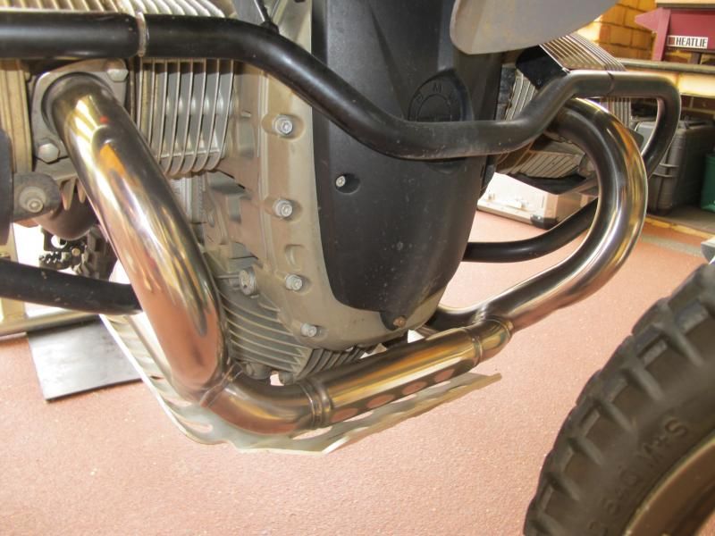

This is how my stock HP2 headers turned out after 15mins or so on the buffing wheel. I didn't take a 'before' photo but they were the typical burnt black/brown colour from 30,000km of dirt and mud.
For approx $125, you'll be able to buff the headers as often as you like. And do other stuff too (see pics 4 & 5)

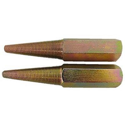

Tapered spindle (12mm if you bought a 6" grinder); $22 (pic 1 below)

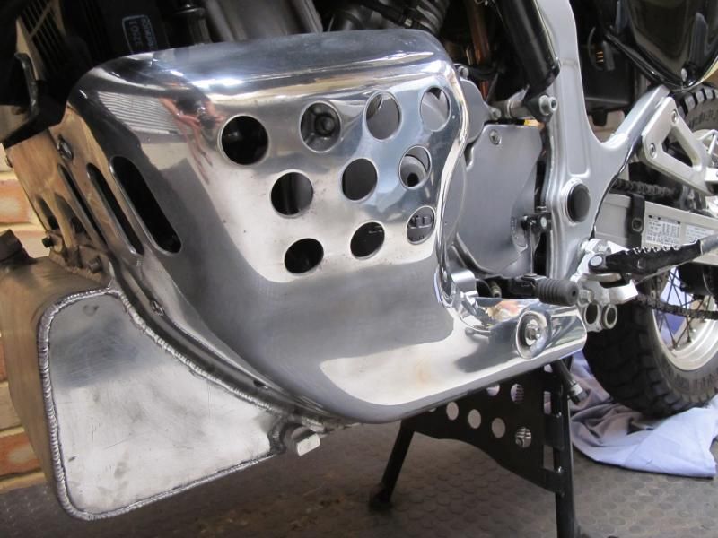

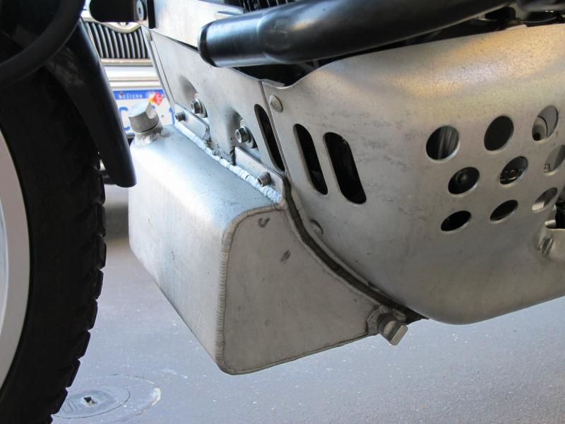

Pics 4 & 5 Africa Twin bash plate. Before and after. Approx 45mins work. Could do better if I spent more time on it.
