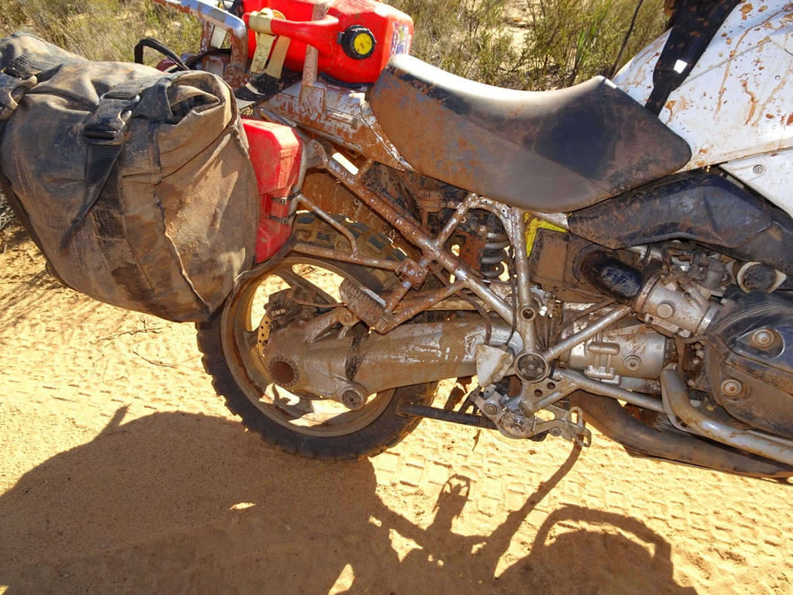

The aftermath of the Upper Kalgan ride was fixing the broken drive shaft on JDs 2008 R1200 GS.
Upper Kalgan ride: http://forum.bmwmccwa.asn.au/viewtopic. ... =15#p17219
The hardest part really is fitting the new rubber gaiter to the back of the gearbox to swing-arm. Must be a technique to that one. Fitting the swing-arm to final drive is a doddle by comparison.
Here is the broken piece side-by-side with the new EI replacement 22 spline drive shaft.
The bike has already had a jaunt over the Holland Track over the weekend.
The EI drive shaft replacement is re-buildable with both universal joints and drive dampers. There are even grease nipples fitted to the universal joints.
