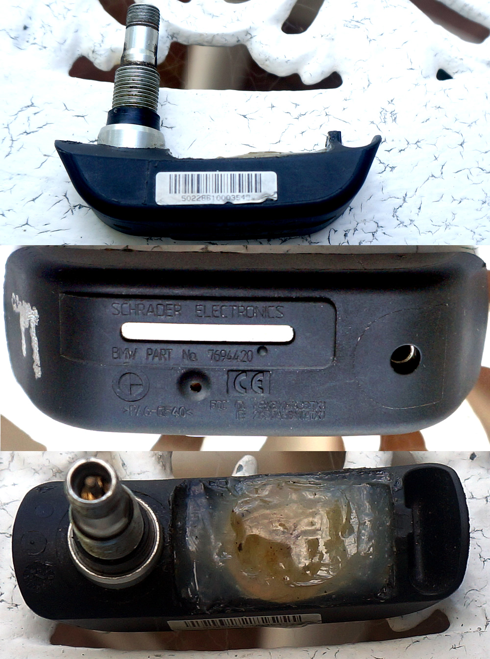

I'm pretty sure the TPM ID number is on the sticker that was destroyed when the epoxy was removed to replace the battery.
All is not lost the bike computer still retains the ID numbers and can be seen with a GS911.
Of coarse if if they have been deleted from the computer. without the ID numbers the units can still be read after they are awoken.
We will be attempting to shift the ID numbers on my bike front to back and back to the front on the tuning day. This is to resolve a rear tire low pressure issue I'm having.
