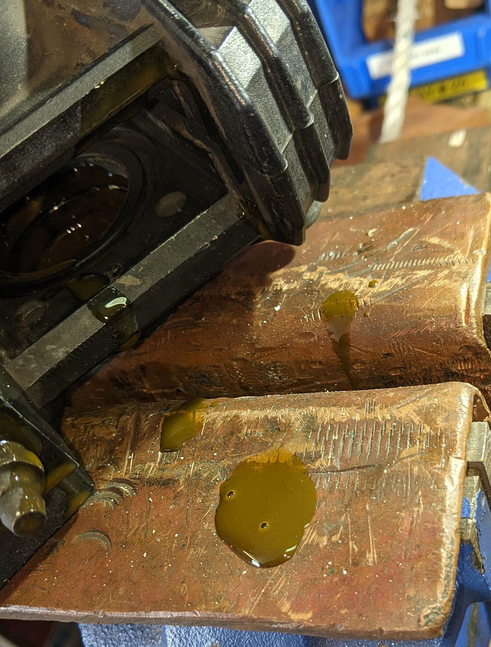

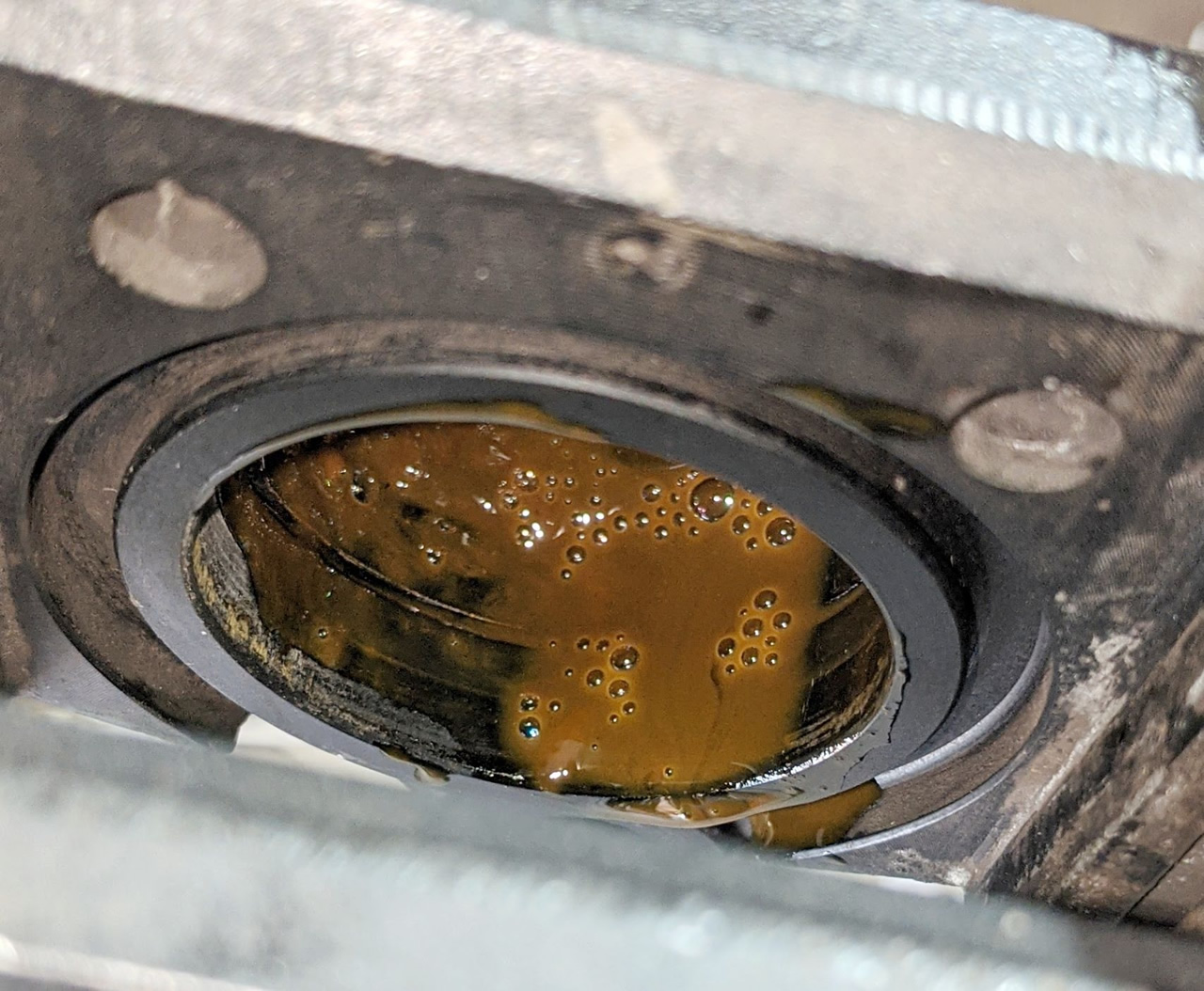

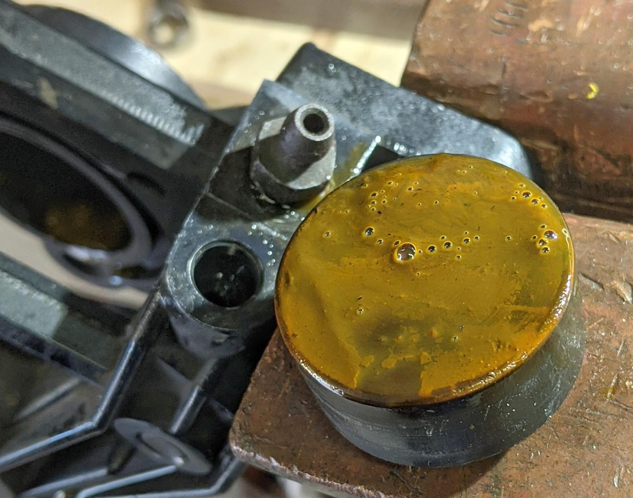

Failure to change your brake fluid will lead to the conversion of your brake fluid to brake MUD. See pics...
In this case, one of the front brake hoses was completely perished to the point that no brake fluid would pass through to the brake caliper.
Thankfully, new locally fabricated brake hoses, brake piston seals and dust covers were sourced at very reasonable prices from HiTech Brake and Clutch Services Wangara. Extremely helpful (and understanding) staff.
