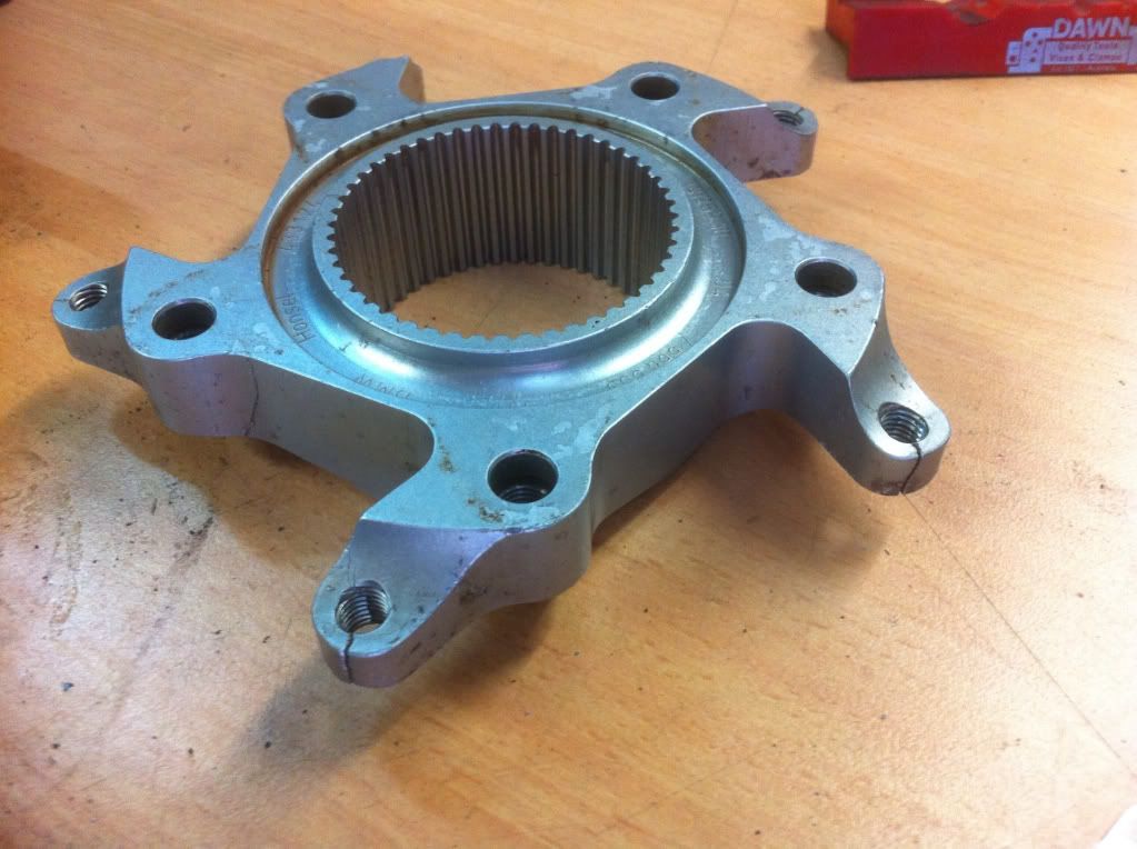

Apparently Wilks had a rear brake disc failure and end up in the bush
Part is common to a lot of other models.
Potential to be mirrored to left and right swing arm models.

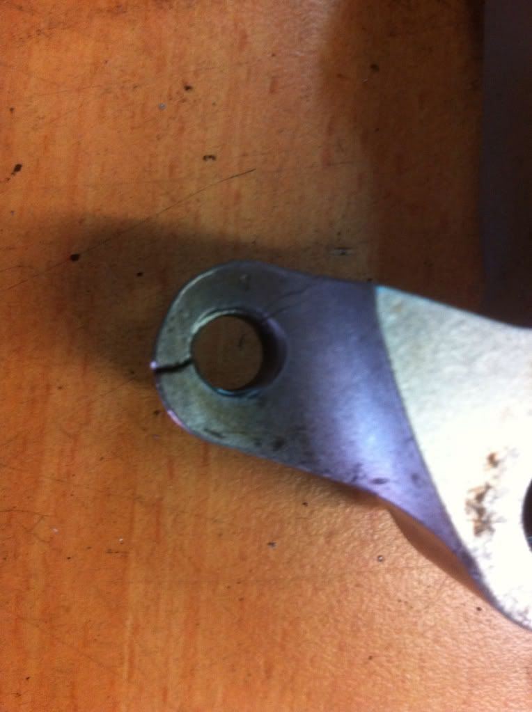

Look for cracks around bolt holding lugs on rear wheel carrier where the brake disc mounts.
Images on ADV rider site.

It's a problem that's been around a while. At first it was thought to be limited to the earlier 12GS models. BMW beefed up the disk carrier presumably in response to all the failures. However the cracks are starting to turn up n some of the later stronger carriers now.
There have been several of these failures in WA. Dave at BMR sees them quite often and recommends you check for the cracks developing regularly, here are a couple of pics of one hat he changed out a year or more back.
