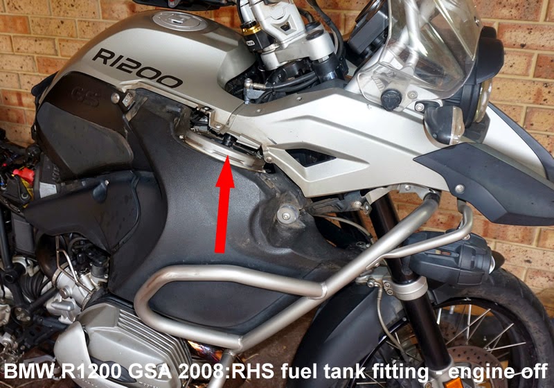

Photo 1: Showing cracks and location of the fuel leak once the engine is started.
Photo 2: Showing the leak once the engine is started (sorry for the blurry image, it was gushing).
Photo 3: Showing the RHS tank and fitting location (Zoom out)
Photo 4: Showing the RHS tank and fitting location (Zoom out

If the fuel pump cover has cracks on the boss (as displayed in the above photos) where the fuel fitting is screwed in, it's highly likely it will be fixed.
Please check your fuel pump covers for cracks.
GS: LH side only.
GSA: LH and RH sides. Mine was the first time that a leak was reported on the RH cover. Leaking like a little boy pee-ing :shock:
If you've decided to fit that clamp on the boss, it's probably because you noticed cracks on same. Get it looked at by your BMW dealer.
