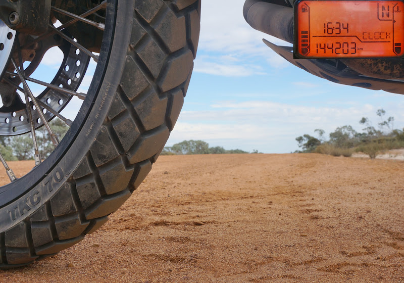

Posts: 1059
Re: Motorbike Tyres - Talk about tyres you've owned
Continental TKC 70
Fitted to my R1200 GSA 2008 at 136,800 km, now 144,200 km
Update: 7,400 km
Longer term impressions:
Very good tread remaining on front and rear.
The front is no longer as silent as before, but still the quietest tyre I've had to listen to on my GSA.
The rear just keeps on doing its job quietly.
Bitumen / Tar: Awesome traction on the tar, particularly out on the edges. It has offered up NO 'pucker' moments in the wet or the dry... The Continental TKC 70s still tip into corners very quickly... and grip.
Dirt roads: Predictable, good grip in the dry. Still no opportunity to test in the mud. I'm sure I won't be surprised when I finally encounter the mud. Very comfortable at speed on fast dirt tracks. I compared comments from fellow riders with knobby tyres on the ANZAC weekend while travelling on very loose pea gravel, and corrugated dirt, where the usual traffic is heavy mining trucks, it would appear that wearing knobbies didn't make a difference. These conditions made all the riders a little edgy :shock:
TKC 70 Front 7,400 km
TKC 70 Rear 7,400 km
Would I buy them again? Yep!
