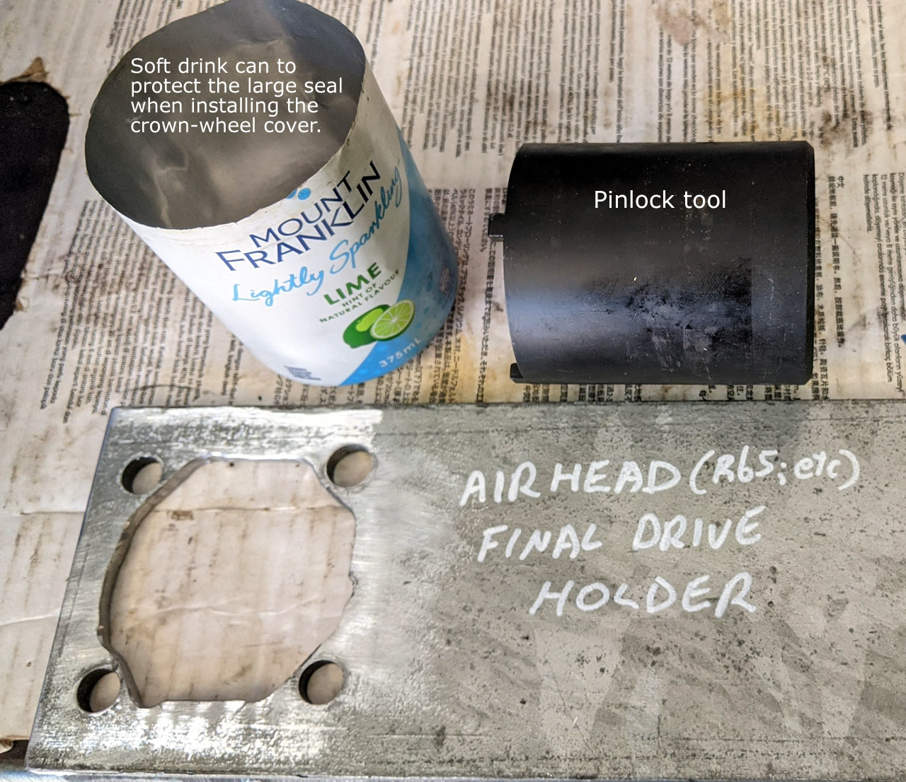

The following special tools are a requirement to overhaul and install new seals into AirHead final drives.
These were used to re-seal a 1982 BMW R65 final drive.
The PinLock tool is used to undo the front pinion seal holder.
The Final Drive Holder allows the unit to be held in a vice.
The Soft Drink Can is used to protect the large seal on the outer cover. Slide the cover and seal over the can then place this assembly onto the crown-wheel. Don't forget to put all the shims back :!:
Install seals in the correct orientation. A seal installed upside down will leak :!:
