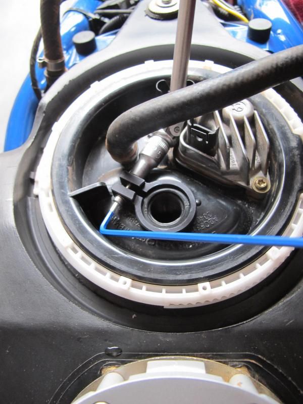

Re: R1200GS Fuel Pump Flange Crack

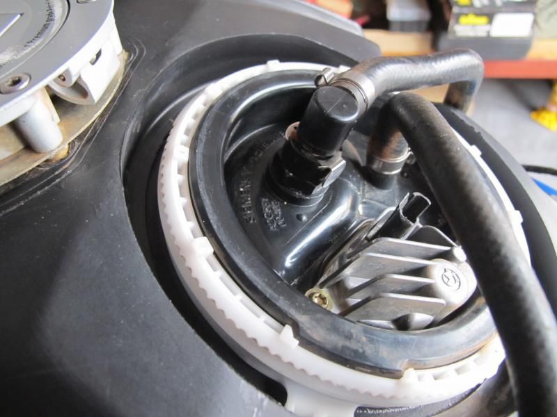

Here's a quick write-up of the fitting of Chris' clamp and replacement of the plastic quick disconnect (QD) to my HP2 which has a HPN tank fitted but retains the OEM fuel pump.
The replacement QD and fuel rated thread sealant was purchased from Munichs http://www.munichmotorcycles.com.au/pro ... ts_id=4824

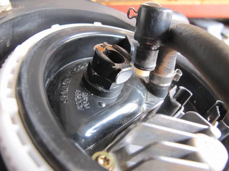

Fuel pump ring removed and electricals disconnected. OEM plastic QD in place.

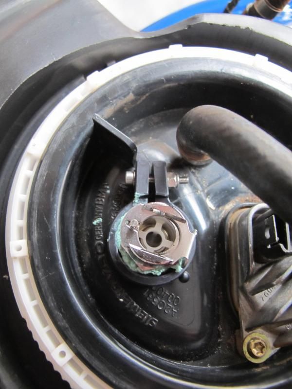

QD (1)disconnected and (2)removed

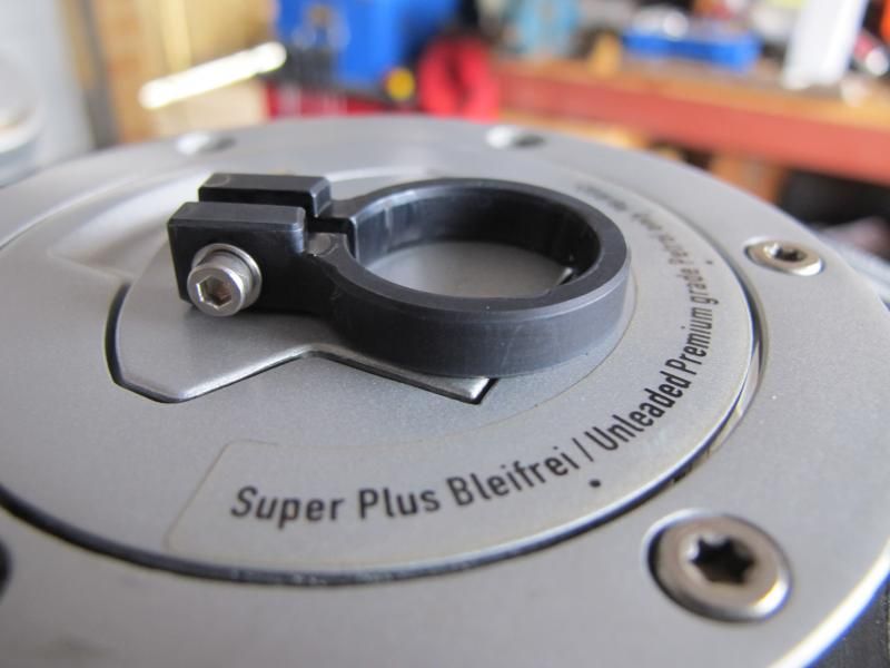

Chris' replacement clamp. NB: pictured correct way up.
You'll need a small Allen key and a 5.5mm socket

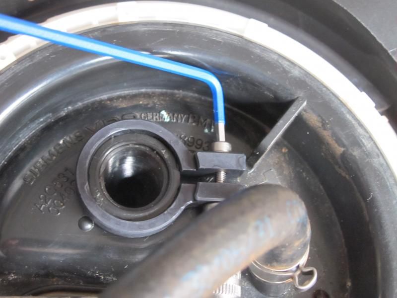

Clamp in place but not tightened. Tighten later.

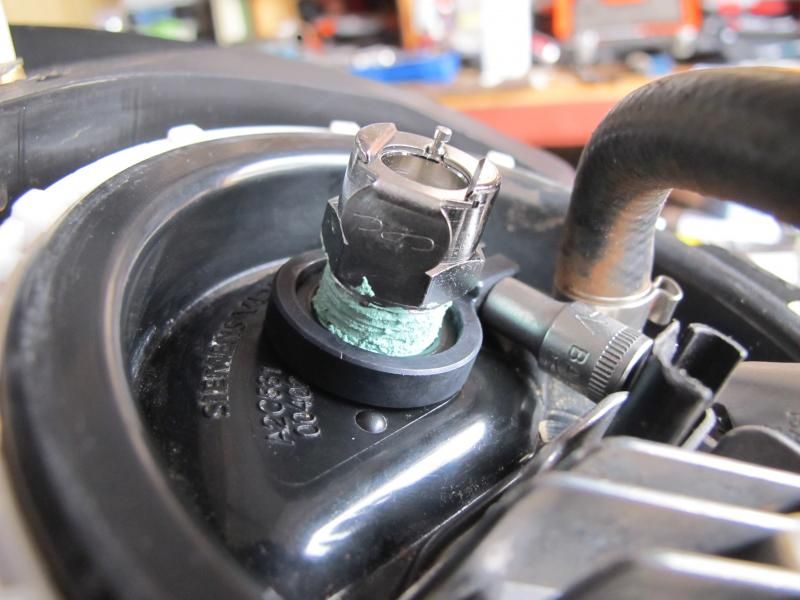

Replacement metal QD from Munichs with thread sealant applied. Screw in hand tight, then turn approx 1/2 turn with 17mm spanner. Leave overnight.
Clamp tightened. Not super tight, just snug.
And that's it. Fired the bike up 24 hours later and no leaks, which is a great relief since the fuel was literally pouring out last time I ran the bike (boots soaked in petrol!). Since there are no signs of cracks on the flange where the QD screws in, I assume either the plastic QD failed (it wasn't loose) or the thread sealant had broken down since manufacturer assembly in 2005.
Thanks very much to Chris for going out of his way to make this clamp for club members and in particular, for allowing to me first go. Mate, I'm more than happy to pay for the clamp - I'll be shoving the cash in your hand next time I see you.
Cheers, Shane
(PS: I'm outta here for a 6,000km - 3-week ride tomorrow morning. Will check in for any questions when reception and time permits).
Cheers, Shane
