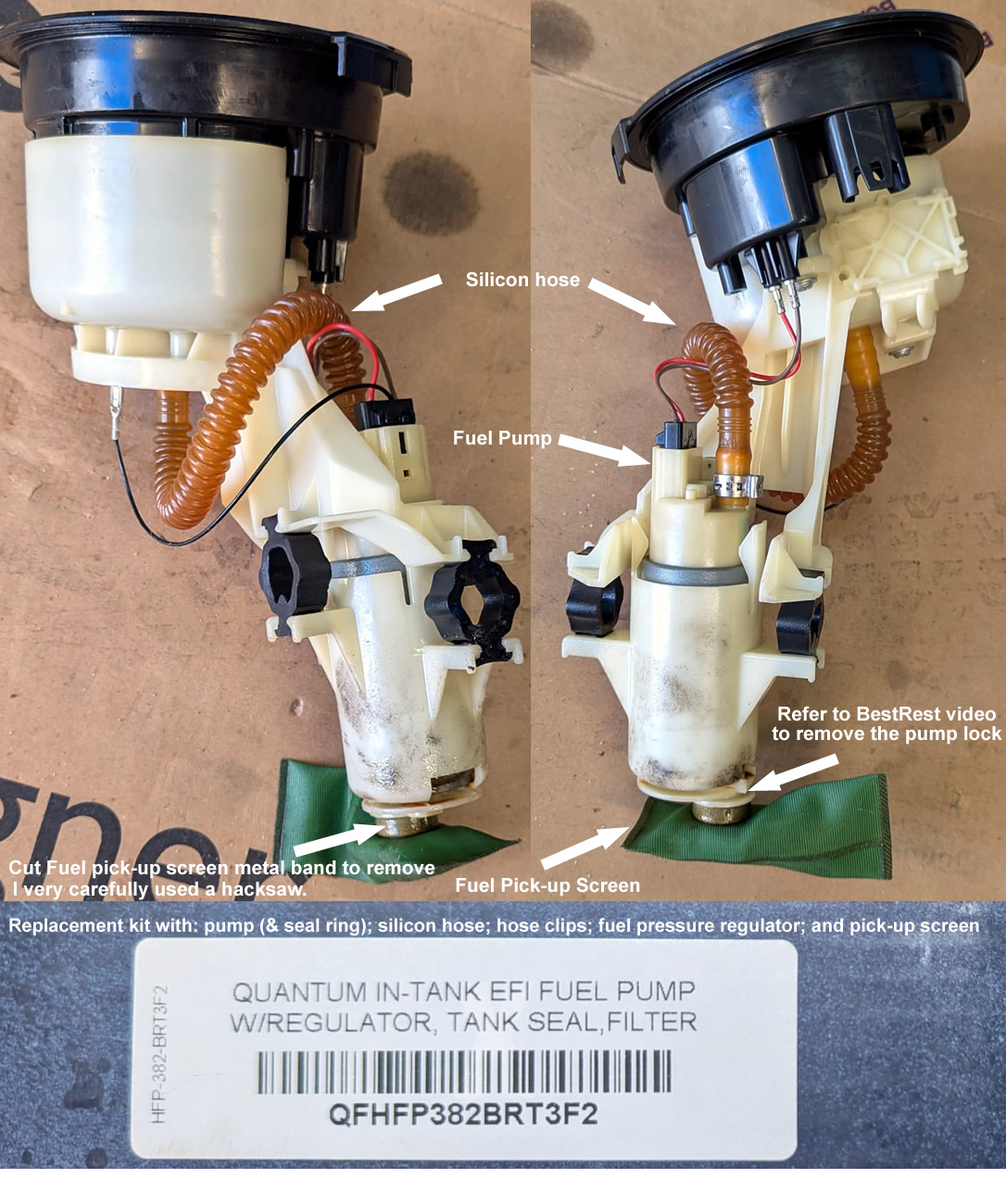

Diagnostic: Bypass fuel pump controller and power pump directly: NO GO.
I removed the fuel pump from the left side. After seeing what was inside, I removed the cover from the right side as well.
The problem was, of course, stale fuel. Ergo, my fault, not BMW. What a sticky mess on the bottom of the tank. And most likely in the pump, causing it to be stuck solid. It would not work directly connected to power.

For reference, I studied this very useful video from BestRest Products.
Watch and absorb it several times! Break the wrong piece of plastic and that'll be $800 thanks.
The fuel pump assembly from my R1200 GSA 2008 - plus Quantum Fuel Pump Kit reference numbers.
It was a fairly straight forward job. Removing the plastic from the GSA is always a drag!
Prior to installing the pump into the pump housing, I powered the pump unit with the bike system to ascertain that the system electronics were not at fault.
The included fuel pressure regulator was fitted. This is at the level of the left throttle body inside the frame. Relatively easy job.

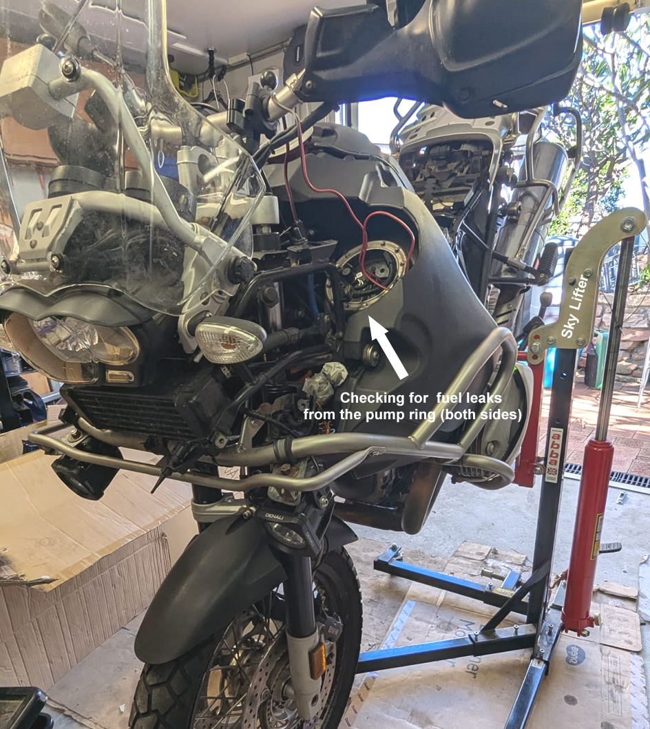

I learnt my lesson years ago when I needed to replace the fuel level strip... Check for fuel leaks at the two (2) pump covers before putting everything back together... Don't ask how I know...
Handy to have a Sky Lifter to tip the back of the bike up high to test for fuel leaks with only half a tank of fuel.
I started the engine sans fuel pump controller to confirm all was OK.
Then fitted the fuel pump controller and started the engine to confirm that the controller was indeed working.
