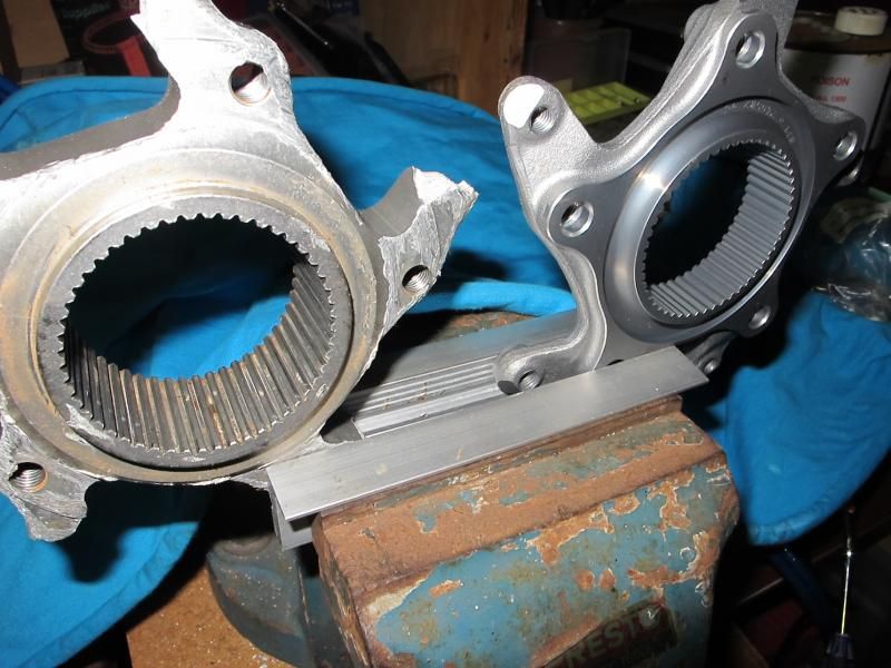

Re: R12GS, HP2 Rear Disk Flange Crack - Check
At last nights club meeting I mentioned that my complaint to the Dept of Infrastructure (Federal) about my broken carrier was currently under investigation. Recently, the investigator ask me if I knew anyone else who had experienced the same carrier failure*. If yes, he asked that I ask them to make a formal complaint to his agency by email asap. He can only consider 1st hand complaints received from the bike owner, not 3rd party stories.
* He is only focussed on actual carrier failures (not cracks only) and particularly those failures which occurred whilst riding. Any supporting photos of the failed carrier would assist the investigation.
Email to: vinvestigations@infrastructure.gov.au
Perhaps mark your email to the attention of Karl.
These are some of the details Karl asked me to provide after I had lodged my complaint:
Could you please supply details for the following:
• Period of ownership;
• Complete service history on the vehicle (for the life if the vehicle and prior to the incident), in particular if there have been any brake/wheel repairs on the vehicle and location of any servicing;
• Are there any modifications to the vehicle, in particular the brakes;
• Location and condition of the road you were travelling on at the time of the incident;
• How was the vehicle loaded at time of the incident;
• Any written communications between you and BMW Australia about your motorcycle;
• Has the issue been repaired and how was it repaired.
Because Davey likes photos, here is a picture of mine and the new replacement part (which is steel, not alloy). :P

:P :P I like the photos' Shane, excellent work, but I'm not liking the failure....
and I bet BMW continue to say "were not aware of any problem", (just like the GS/GSA centre stand bolts shearing, - and several club members have also experienced the same issue......and again...."whe are not aware of the problem"...
